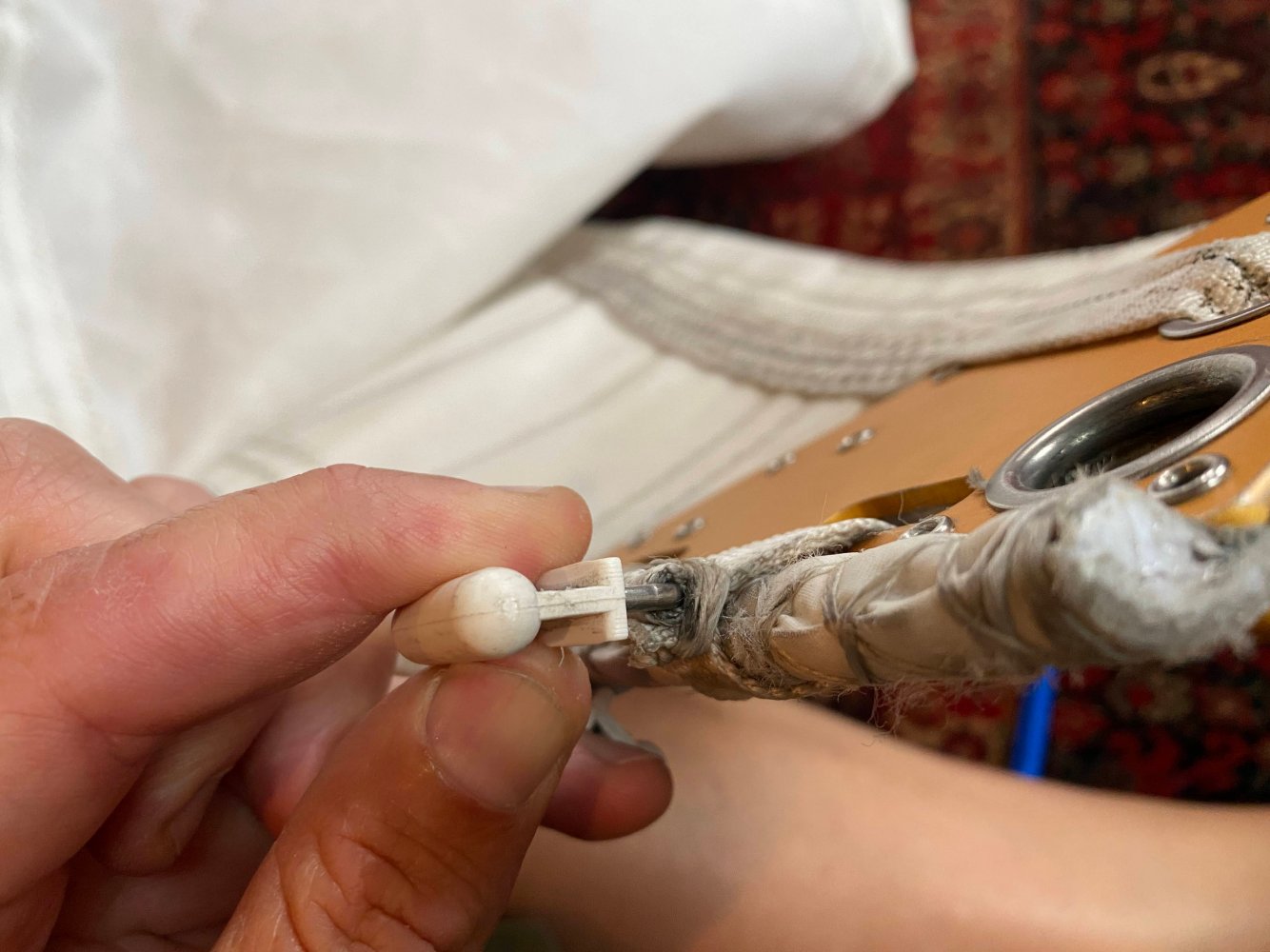

We installed this on our 32-2 about five years ago. Super easy installation. Makes every tweak of the main easier. We coupled this purchase with a new main sail, as converting the slides on the old sail was a few hundred dollars I think.
