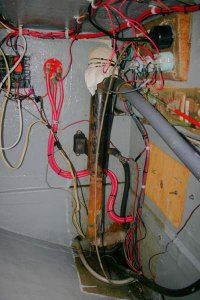

Based on what was mounted on my E-38, I am guessing that what you are talking about is Ericson's version of a siphon break for the exhaust riser - at least that is the answer I once got from Don Kohlman over the phone.

This is a pic of the old muffler. This weekend I will take some of the new one.
This is the original Muffler installed by Ericson. The one that you would get from Pacific Seacraft is slightly smaller in diameter. I will have the pics of the new Muffler posted on Tuesday (my sunday).

It's not a water lift or heat riser. Siphon breaker is sounding right.
I'll try and take a pix tomorrow.
