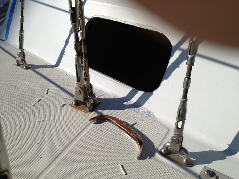

The most neglected part of the panels is at the aft corner of the port port light, where serious rot was allowed to flourish. I have removed all of the softest wood to reveal part of the fiberglass interior surface of the house. In the image below, some layers of the plywood have maintained integrity. The thickness of the wood panel is 3/8” including the surface veneer.
I expect soon to receive a couple of packages of a few square feet of teak veneer. I had thought I might be able to replace the rotted wood with filled epoxy or Bondo or whatever, and then to cover with teak veneer. But given the extent of the injury, I think maybe I should remove more solid wood and replace with a suitably shaped piece of new panel with integral veneer.
I’ve been dreading this piece of work, as fine finish work has never been part of my skill set, so I hope someone or some several here can help me figure out the best way to reasonably return my teak panels to a presentable condition. New veneer is an option I have considered, but if there is a way to reasonably repair the rotted area while preserving the remaining original teak with its handsome figure, that is what I would prefer.
I have used Rockler sticky-back veneer to turn small pieces of plywood into teak, and it looks great. Whether it matches the existing, well, probably not perfectly.
Yes, you could make a straight cut of the entire after portion, including a few inches of the portlight area. Remove wood down to the glass. Construct veneer with backing to match the depth, Glue it in . Labor of love. Depth of piece a challenge. Wouldn't match. Might look neat, at least.
You could trim the rotted area into a square, for neatness, then layer epoxy in to match the depth. C-clamps could maintain smooth surface, since the portlight is removed. Epoxy thickened with 205 filleting Blend is conveniently teak-colored (it's essentially sawdust). The repair would always look like a repair.

If you're going to put in a patch, I don't think there's any way to completely hide it. I'd be thinking about how to shape the patch in a way that it makes sense with the other geometry in the panels.
It might be worth scarfing the joints between old and new. A straight butt joint will show a more visible gap.

However you attempt to cut a patch, you are going to see it. Even if the joinery is perfect, the grain mismatch alone will reveal it. Your next best option would be attempting to re -veneer the entire panel after patching the rotten wood. If it were my boat, I'd rip off the entire panel down to the glass and start over from scratch, but having done this myself, I can report it's a lot of work.
Update from my earlier post, I managed to patch the damaged area to my satisfaction, as shown below:
I removed the rotten veneer and underlying plywood for a defined area and cut a filler piece of plywood to match the area.
The filler plywood was epoxied into place. Once cured, the teak veneer was epoxied over the new plywood.
The finished patch is clearly visible, but it looks pretty good to me. The Admiral figures there is no need to replace the teak plugs to cover the fasteners in the trim, and I agree.

@peaman - your repair looks great! Better than I would have ever imagined.
