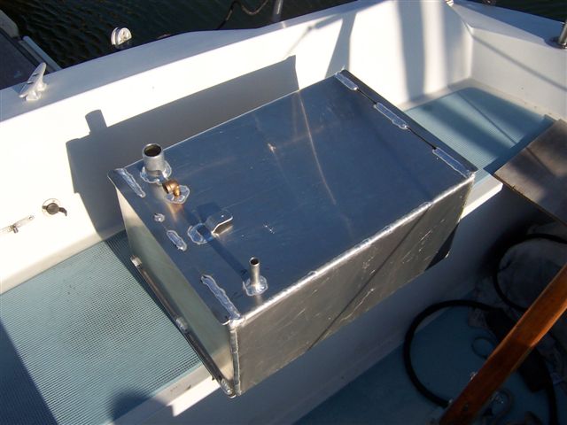

My new aluminum tank was made by:
Berry Sheet Metal. 764 Newton Way Costa Mesa, CA 92627 Tel: (949) 548-3613
They were the original vendor to Ericson for new tanks.

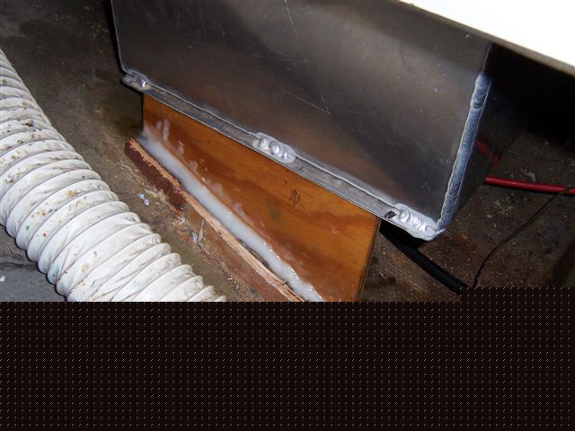

However, I wasn't entirely satisfied with the whole process. I removed my old tank and took it to them and said I wanted an exact replacement (except in aluminum). Before making the new tank they LOST the old one. And, of course, they didn't have the original drawing in their files for an E27 tank. %^&**
So .... I made up a drawing as best I could from where the inlet fitting was and the old supports. It's been a while, but I might have taken some approximate dimensions off the old tank before I gave it to them.
When I got the new tank back it was slightly off by an inch or so (to my drawing) in the widest dimension and it wouldn't fit the old support position. $%^&* again.
Anyway I got the thing installed and that helped a bunch with my problems. However, until I later replaced the coil and the fairly new electric fuel pump I wasn't completely "problem free".
FYI, if you order a tank from them it will be made from my drawing (which went into their files) and won't be an exact match to the old one.
A couple of pics attached showing the new tank and also how it didn't match the old plywood support on the starboard side.
