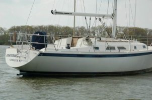

First the situation: My E35-2 has had the boom shortened almost 3 feet. Also the traveler has been relocated to the companionway (you need to be careful coming on deck when underway!) I have the replacement boom and am soon to install it.
Now the dark side? the original traveler was located just in front of the wheel. A situation I see as not a lot better than it blocking the companionway. As it has been gone for decades, the space has been replaced with tables, interments and the like. So the thought has come to mind that the guys at HUNTER may have got it right when they moved it onto a tower above the cockpit. Also, I am conflicted as I dearly want to preserve the perfect lines of the boat, but also like the idea of the tower and dodger and bimini etc.
Before I commit to drastically changing the silhouette of my boat I would like to elicit the thoughts of the brain-trust on the relative merits and pitfalls of such an undertaking. So go ahead Shoot! :egrin: Edd

An arch is a heavy thing..
There are a lot of design issues here..
First lets take a look at the hull form of the two boat, your 35 and any of the hunters with the arch. The stern of the hunters is much broader, with much smaller overhangs. The buoyancy of that stern is part of what supports the weight of that arch.
All of the added arches for either Solar Panels, Travelers, Radar etc that I have seen placed on boats have three very negative effects. The first is that since the hull shape was never designed to have excess weight located that far aft, the boats no longer float on their lines. In some cases this causes major issues with storage in the aft lockers no longer being usable for anything, other than toilet paper storage, and can cause the boat to handle poorly without any of the other factors. They tend to weather cock the boat when sailing inducing some weather helm that further makes the boat sail poorly, and lastly they all detract from the lines of the boat by looking like a stainless steel oil derrick on the stern.
My recommendation, put the traveler back where it was designed to go.
Place the instruments on the forward bulkhead of the cockpit, or in a nav pod over the companionway. The boat is going to be easier to sail, faster, and look pretty like an Ericson should.

Well that is resounding and from all the names I most respect! @Martin: Your first post was my thought when I bought the boat... Why would anyone chop up the boom! The answer I got was that it was originally raced extensively and the smaller mainsail capability gave it a better handicap and since it mostly ran in the SF Bay the hinds usually called for a reef anyway so it was a net advantage because the boat would still balance well with a bigger head sail and smaller main. I guess it worked as the boat is covered with first place placards from 1972 to the early 90's. It has been my experience that the boat is VERY forgiving and loves to run no mater what rags are on the pole. It will easily do 8 and if you work at it 9 knots, much more than I believe it should.
I am restoring its ability to carry its intended main, as I expect to take it on an open ended cruise in the next couple years and want to be comfortable in the widest range of wind as possible. As I guess the Admiral will come along I am looking also to keep as much peace as possible as well and She Hates the traveler where it is so it is moving but back to its original location probably won"t make her happy either. Compromise is often the smart way out. I guess I needed to know where to put my foot down and have a ready reason why! Thanks guys.

The traveler is definitely going aft as God (Bruce King) intended it. The only Question would then be is it worth the extra weight and probable funky look to raise it to allow for the Bimini and cockpit table etc. and get it out from under foot while sailing. I had not considered the weight issue, but suspected it would be offset by that all chain rode that is on my Christmas list. Also since the wife WANTS the dodger and Bimini anyway, the aesthetics issue is already present. With tasteful engineering it might be doable. I don't like the idea of dragging a tent around on the back of my boat, but if I gotta, then should it not be as functional as possible? I see all these cruiser boats with there sterns loaded down with so much clutter and look at the beauty of my simple classic clean lines and swear mine will never become that, but then finding room and making everything work together is a difficult comprise. There is much improvement in the function and space of my boat from when i first bought her. the cabinets used to be access to the plumbing and wires. with a bit of work (Sometimes a lot of work) all that hose is now neatly in a corner next to a wall and there is room to store things that make life aboard pleasant. As much as possible all the boats inner workings have been moved to the wasted and otherwise unusable areas. So now lies the conflict as I can see the idea as continuing to increase function, OR destroying all the extra work that made the boat livable by only cleaning up the compromises made to make production easier while keeping it looking and sailing as it did when it was new. The question I know seems silly but it has come after much thought and argument within. I know it is probably wrong, but there are benefits I can't deny and I am truly stuck for arguments against it. (both Guy and Martin saying NO is the best one I have found so far!) Edd

Your 35 i think is a simlar hull to my '87 34; so balance points should be comparable; why not a traveller in front (meaning forward ...) of the companionway, ala...
