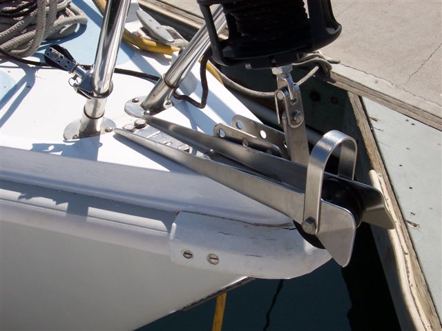

:egrin:Anybody done an anchor roller on an E-27? Any ideas about bow sprits? Teak? Stainless? 2 anchors?
Mike & Cheri McNulty

I love that homemade sprit/roller. I have been thinking about doing the same next year. Thank you, I would love to see any more pics that you have.

I took a stock roller from WM and put it on the bow of my E27 a few years back. In order for it to come out as straight as possible, I cut into the bottom and side slightly so it would fit over the edge of the stem fitting. Got to zoom into the picture to actually see it. Weakens it some, I'm sure. Hopefully I won't get in that big of a blow to find out how much weaker. :)

I installed a Garhauer a few years back. If I still have their info I'll get you the model number. It was 85.00 at the Strictly Sail Show In Chicago. Its larger and longer than the one in the pic you recieved. I angled it ever so slightly to fit between light and furler. Its through bolted bedded etc. Rod
