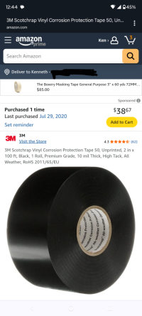

Tom Metzger
Dear friend, I've had great luck using 2" wide pipe wrap which is essentially electricians tape on steroids.
Pipe wrap is designed for protecting buried pipe from corrosion. Great stuff. Utility companies used it by the carload to protect gas pipes. From a previous life.

Guy Stevens
I use this
http://www.amazon.com/WILLIAM-HARVE...456778796&sr=8-31&keywords=gas+pipe+tape+wrap
or a local purchased version of it.
Most plumbing supply houses have it in stock for about this price or a little lower.
Works great. No issues with removal when you need to take the mast down for renewal and painting. (Remember you will have problems painting, or anodizing, any surface that has ever had silicone on it before).
This and Tef Gel, and 20 years from now it will all come apart as easily as it did the day you installed it.
If you need something to stay in place and are worried about it, use a good blue thread locker instead of the tef gel.
